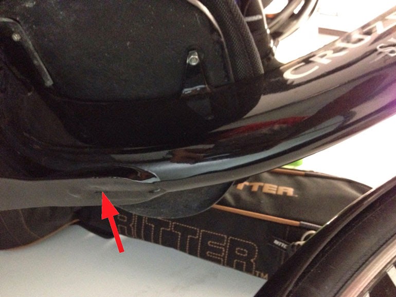

I'm thinking of routing some wires and possibly my batteries into my frame, and routing wires through the boom and the frame. Do you think it is safe to drill in the location shown below?
IMG_5851.JPG height:578px; width:770px
Also, can I seek advice on technique from you frequent Di2 drillers. I have a Dremel but no "workshop" to clamp my bike/frame etc. I have never drilled into a frame before. I most frequently use my Dremel for it's cutting discs (eg. cutting my handlebars). Is it okay to drill the hole with my Dremel just by hand? Should I start with the smallest bit? Or even with the engraving bit to mark a little hole so the drill bit later doesn't skip around?

Amateurs like us should use Boelube
Then you need a drill bit depth stop to make sure you don't drill clean through the back side; this one is good and cheap
Dipp your drill bit into it; and then drill; Aluminum is usually drilled at 900-1500rpm; hence the no dremel recommendation too easy to go too fast.
Drill bits themselves there are a variety of opinions but I like the titanium ones with the Pilot Point
You have to really fasten the frame to something. I've been using a Workmate for years mostly because it collapses to nothing and for miscllaneous clamping Wood Handscrew Clamps

My Silvo 2.1 frame has two rear brake exit holes. Any way you could just use that 2nd hole if you have that on your 2.0 frame?
I would echo ratz and look
I would echo ratz and look for another route before drilling. What would the wire routed via the hole in the bottom be for?
Robert
Ratz - Nope, my Silvio 2.0
Ratz - Nope, my Silvio 2.0 frame has only one brake exit hole.
Robert - it would be for power to my under-seat traffic cam that would run in a looping fashion every time time I ride. Ideally it would be connected to a battery pack that would also run my very bright front lights.
Thanks for your thoughts and advice.

If I were going to drill a hole in the location that you showed, I would use a twist (standard) drill. I would lay the bike on it's side and drill the hole by hand. I would use a center punch to put a small dimple in the paint or aluminum so that the drill would not walk before the bit could engage. I would drill a smaller pilot hole first, then go to the finished size. If you decide to do this, be very careful when the bit breaks through, because they tend to grab and may pull or twist the drill in an unforeseen direction.
Another method that you may want to try is to use velcro to create a channel between your seat and frame. Cut a male and female velcro patch (maybe an inch long or so). Attach male and female together, sticky side to sticky side. Attach these on either side between where you want to create a channel for your wire, between your frame and seat. I measured some velcro that I had in my shop. Two halves attached and compressed measured about 0.100". If you remove the existing velcro on the frame and seat back (maybe 1/2") you should end up with a 0.200" channel. I am thinking that this may be sufficient to allow your wire to pass through the 1/2" wide channel that you have created. To dress up the wire you could use black electrical tape to hold the wire against the frame. I have used black electrical tape on my Silvio and I think it will be difficult to see against the black Silvio background. I have never done the velcro channel thing before. I am trailblazing here, so if you try it, I would be interested in learning if it works or not. At least this method is reversible if it fails. I think maybe the best place to place the channel is where the natural discontinuity between the frame and seat is greatest (maybe at the radius where the seat pan attaches to the seat back. You will have to experiment.

Buddy, that velcro as a channel is a super idea. I have black tape as well on a few parts of Silvio for protection that is hardly visible. There is a larger space between frame and seat where the upper-lower parts of the seat join. Thanks!
