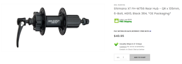

they are saying it is a FH-M756-L XT rear disk hub 32 hole 6 bolt disk. but can't find any in stock or anything compatible.

Google tells me you have a “Deore XT rear hub designed for mountain and touring bikes” and uses a “Shimano HG freehub”. $52

Judging by the last 2 posts if thats what you need it's cheaper to buy the whole hub and just swap the freehub over rather than get the wheel re built. But I'd say it's probably a maintenance issue as Rojoracing said. Maybe get a second opinion.
