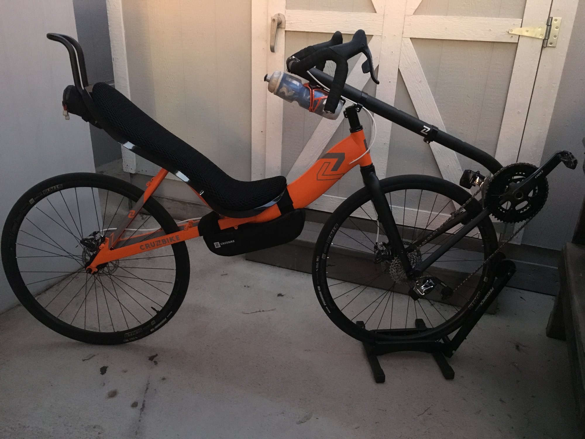

The S40 is a much bigger bike than the 1.0. I had to stretch my bike rack out to accommodate it and now, I can see wheel sticking out on either side of my car, from the side mirrors. I haven't measured, yet, but I'd say the wheelbase has stretched a good 4 inches.
The S40 sits up higher than the 1.0. Again, not measured, but I'd say a full inch, maybe two. I will gather more details on that in the near future. Here's a pic.
Being fair, the S40 is sitting on a stand and the 1.o is on the floor, so give back maybe an inch. Still, it is clearly higher.

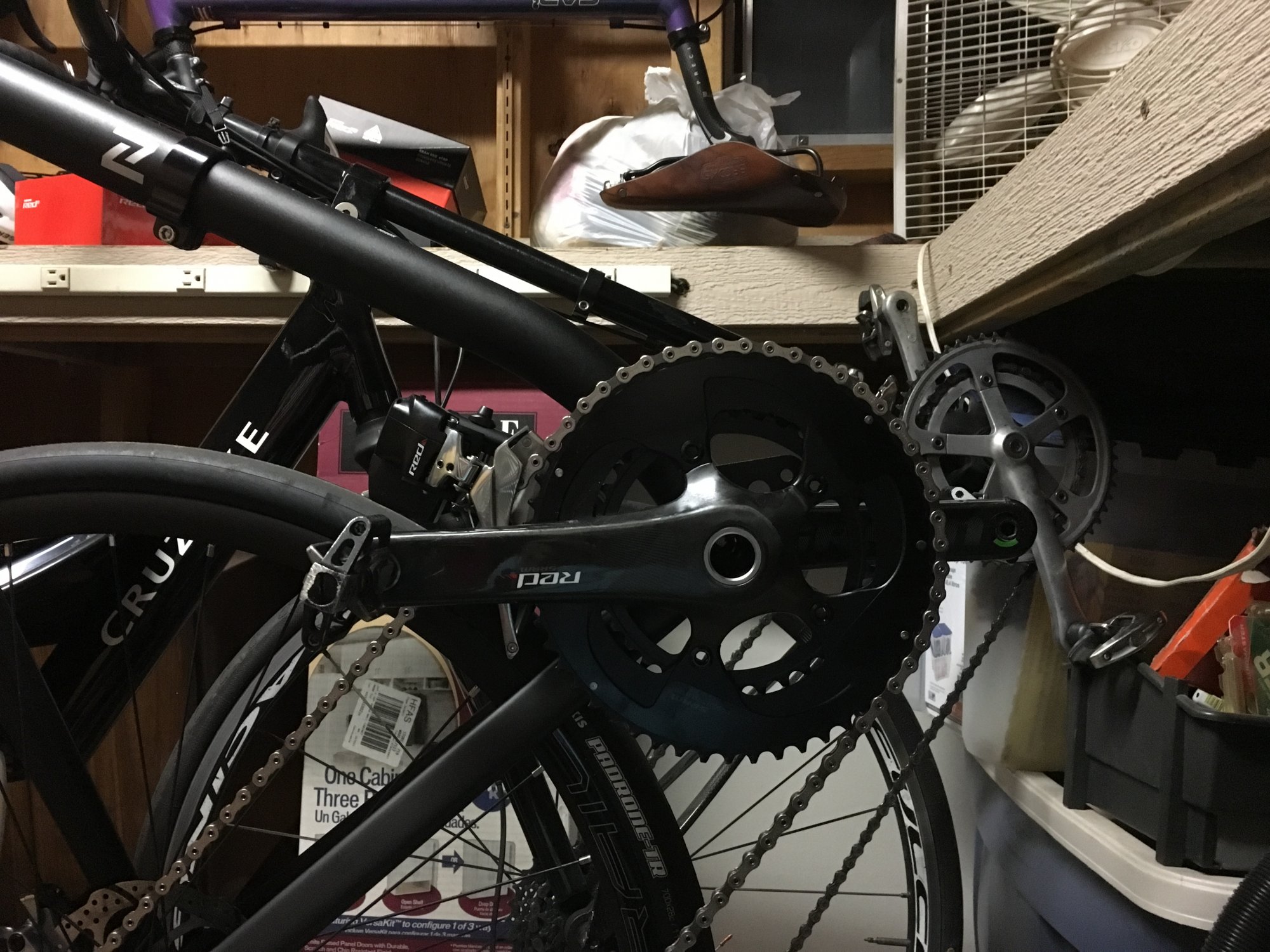

Maybe hard to tell from this angle, again, the S40 is sitting on a stand, so give back an inch, but given the difference in the seat height, it's a lower bottom bracket. Much lower and I felt it on the test ride. I felt slower, especially on the climb, but I know this is an acclimation thing. As is the width of the chain stays. I got some heel strike on the chain stays. I don't like that, but I will get used to it and accommodate for it in the future.

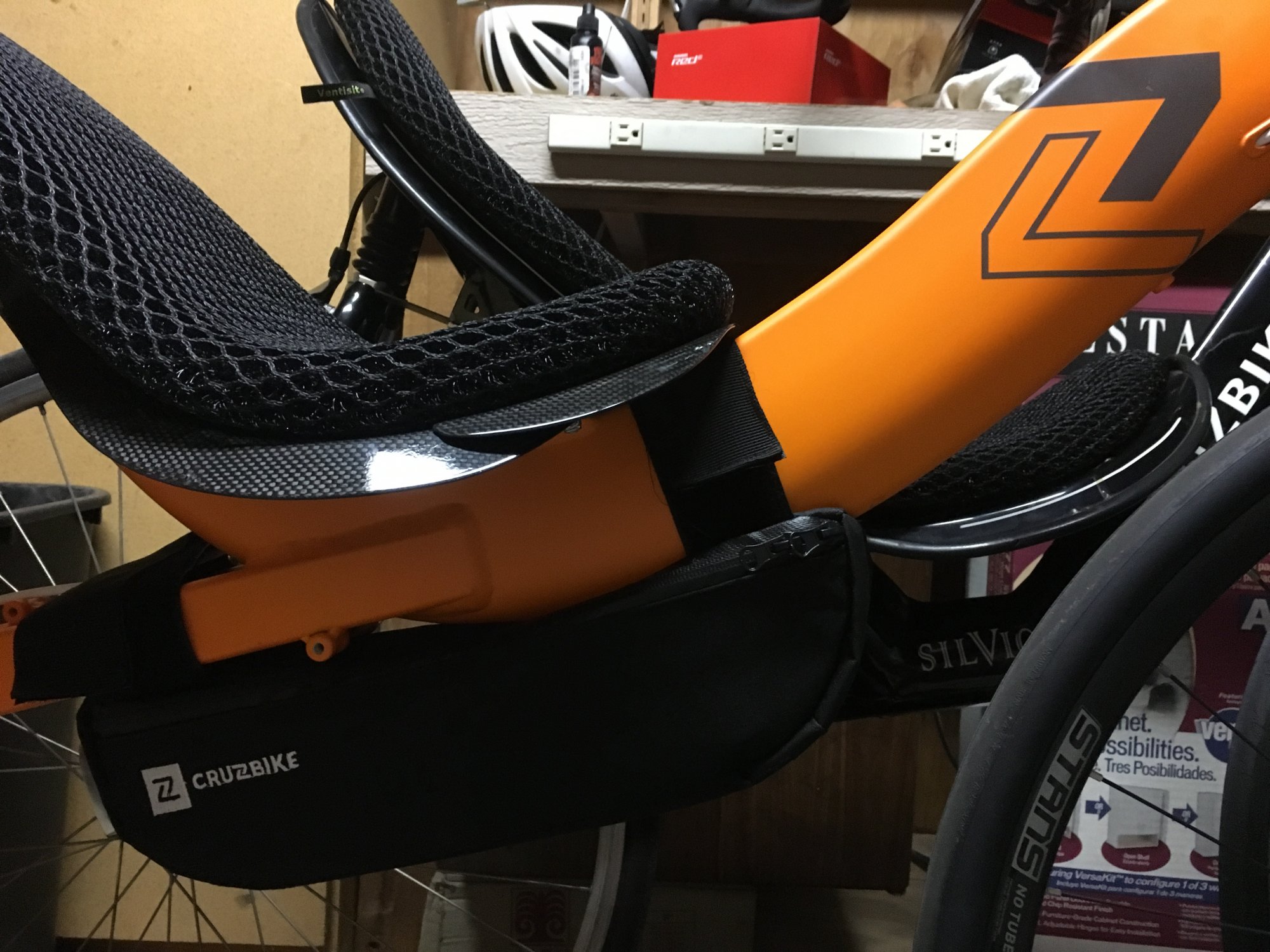

The seat is..... different. The nose of the seat is almost non existent and I thought I might have a feeling of wanting to slide off the front. So far, that hasn't been the case, but the jury is still out. The old Silvio seat gave you a feeling of sitting down in it, not on it. Maybe this will be better for recumbutt, we shall see. Then there is the water bottle bracket mounting issue. I still haven't sorted that out. Not to my satisfaction, anyway. I really don't want to bolt more stuff to the bike, at this point (ie, the headrest bottle mount adapter thingy). Speaking of which, to me, the headrest thingy is pretty much useless. I threw the pad in the corner. I did find that the frame for the headrest makes a good place to hang my seat bag and I will use it for mounting a tail light, at some point, so not completely useless. Otherwise, it just gets in my way throwing my leg over the seat back. Again, going back to the higher seat and then the head rest.... Much bigger challenge.
I weighed both bikes and the S40 comes in a full two pounds lighter than my 1.0. I was hoping for a little more difference than that, but given the longer wheelbase and higher seating position, I guess it's pretty good that way.

Nice looking build. Wondering what your final weight is with all the bags, pedals etc on board.
Also interested to hear how you like the sling bag under the seat. Looking at that as a possibility. If you are like me (6'1", 190 lbs) you may find that water bottle mount to be a problem. It's handy but I found I was always getting poked in the stomach and occasionally found myself banging my thigh on the cage during starts or unexpected stops. I went with an under seat cage mount that you can find on a bottle cage mount thread. Enjoy. It's a sweet ride!
