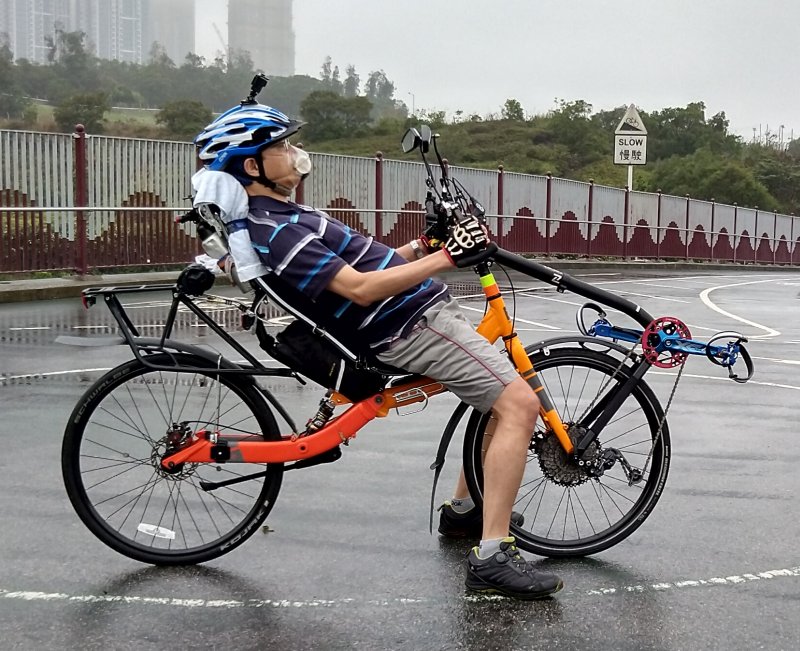

barung
Helpful info. I'm 5'6" and 40" x seam and have been trying to decide, thinking the seat height is too high. The 'fit' info from the website is all about the stretch to the pedals not about whether you can comfortably get your feet on the ground, especially with a full load of panniers and rough terrain when you most need solid footing. Thanks Giloun for the photo. Much appreciated. Could you put one up with both feet down?
barung
Thanks for that Giloun. Good to see you can get both heels on the ground. That makes for good stability when you need it.
