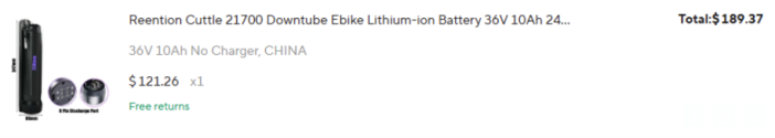

I purchased from AliExpress this product:
It took about a month to get to my home in the US. To install, disconnect the red and black cables that run from the existing battery bracket to the controller and remove the existing battery and battery bracket from the bike. Use the two bolts that you just removed to install the new battery bracket. Note that it is bigger than the old one. Make sure you install it with clearance for the front tire.
