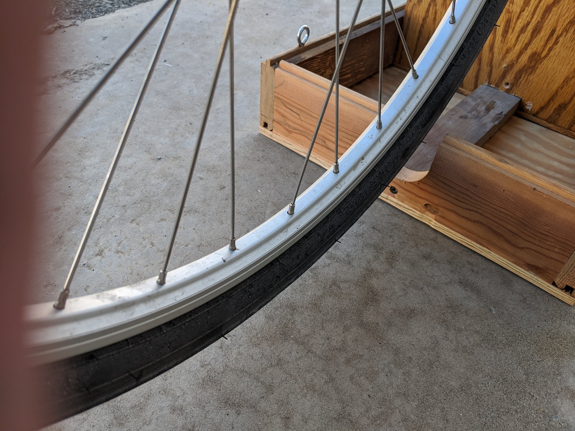

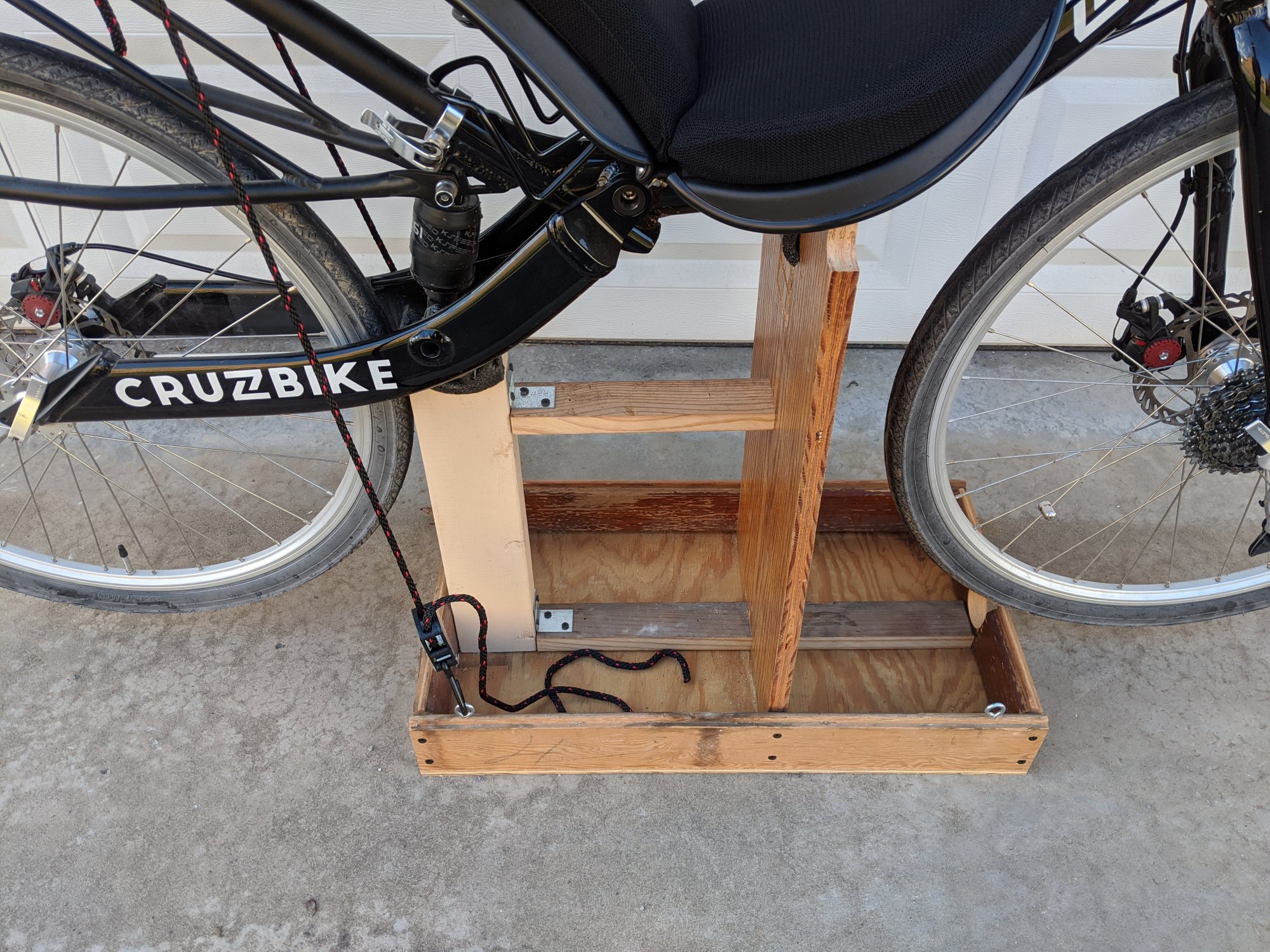

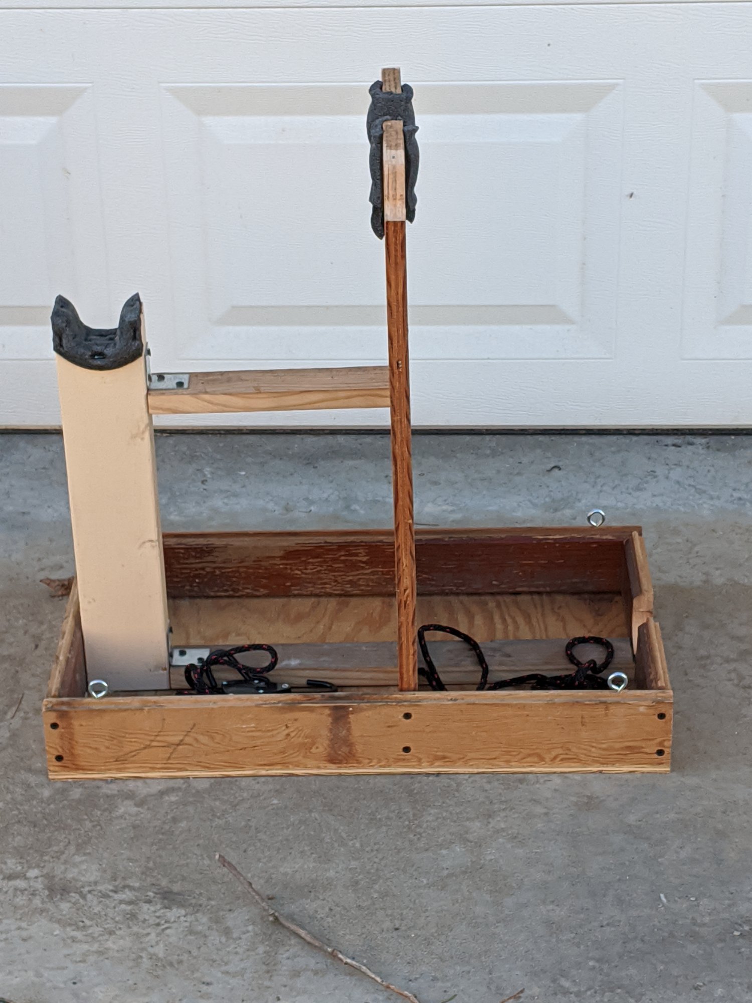

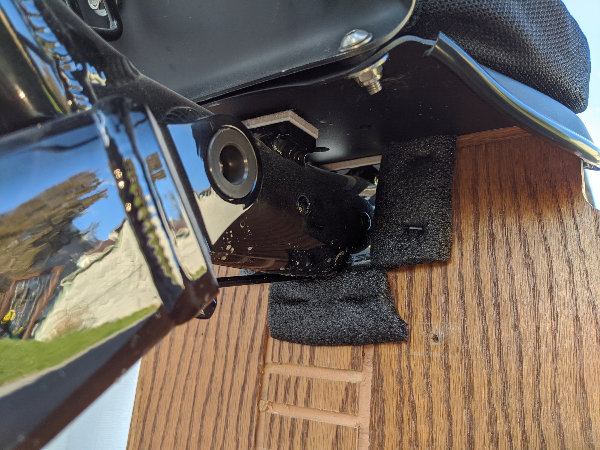

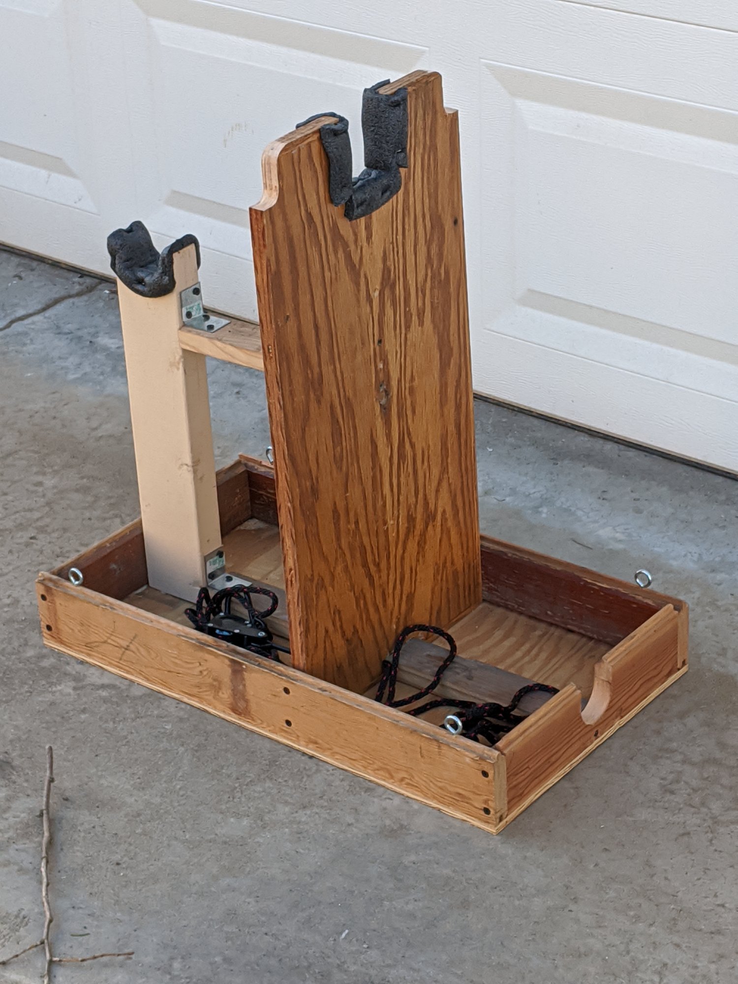

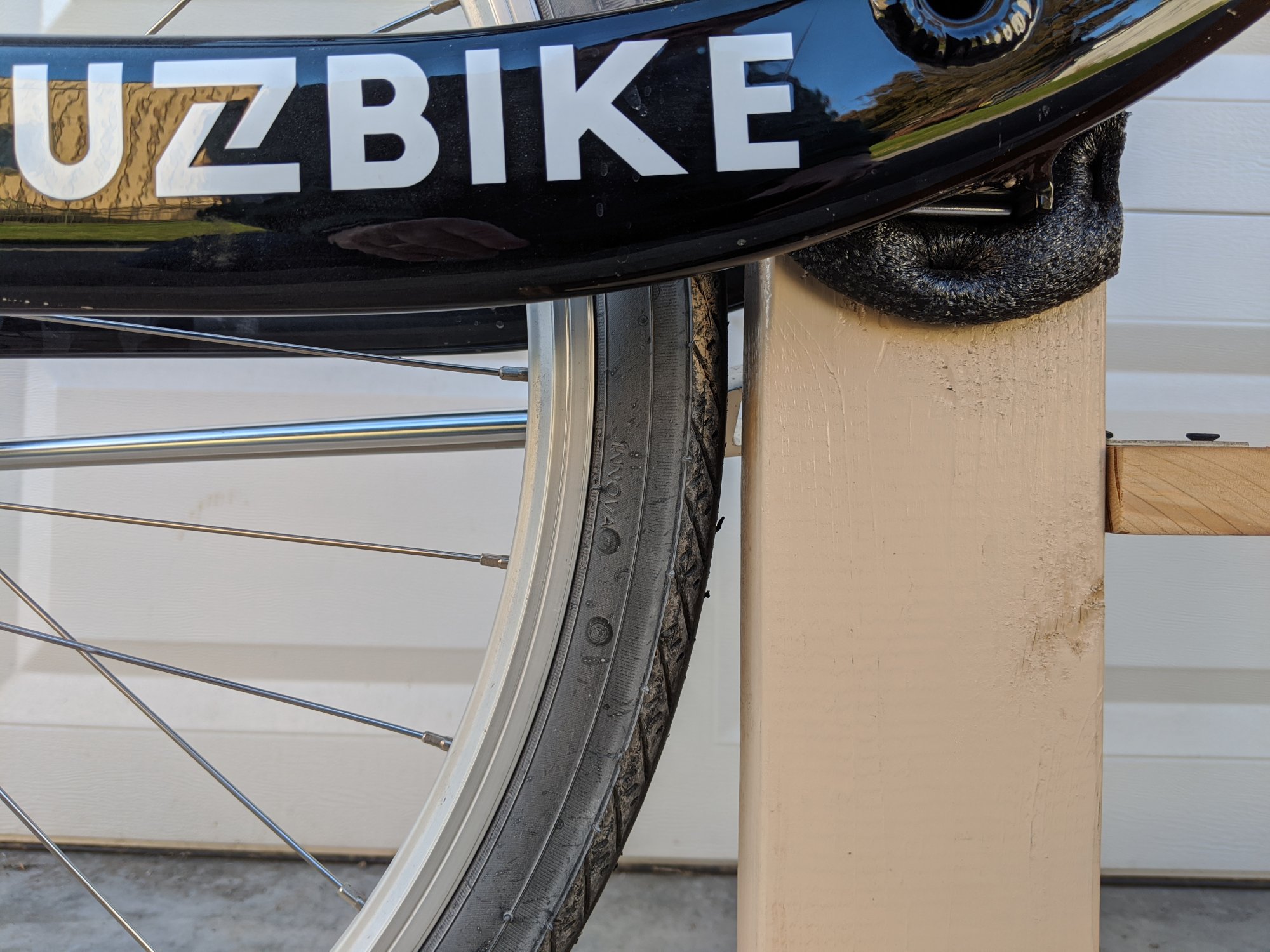

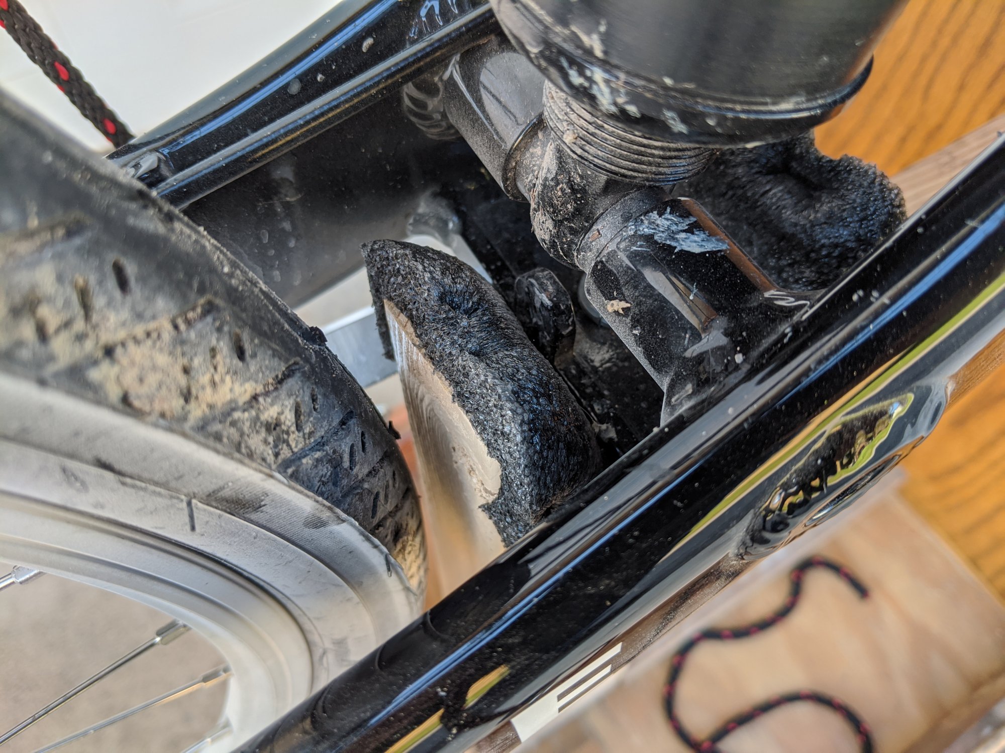

I wanted to share my homemade solution for a work stand for my QX100.
It was made from scrap pieces of wood I had in the garage. Screws, L brackets and eye hooks were laying around.
I had to buy 1 piece pipe foam insulation and a 2-pack of rope ratchets - less than $15.
I hope that the foam insulation will keep from scratching the frame when putting it in and out of the stand.
The ratchet straps were not necessary - as the bike sits solidly in the stand without them.
The rear ratchet - I call it insurance to keep the bike in the cutouts.
The front ratchet - just stabilizes the front wheel so that it does move when winding up the front wheel while adjusting front brake or derailleurs
the really nice thing is both wheels can rotate freely once the bike is placed in the stand. It makes checking the brakes for rubbing or adjustments a piece of cake.
The bottom serves as a tray for parts, screws, and tools.
The cross brace makes a nice handle to move the stand around when it is empty.
This will likely stay in the garage as I think it is too bulky to transport in the car for most occasions.
I am happy to say that it serves the purpose that I needed.
I welcome questions or comments.
