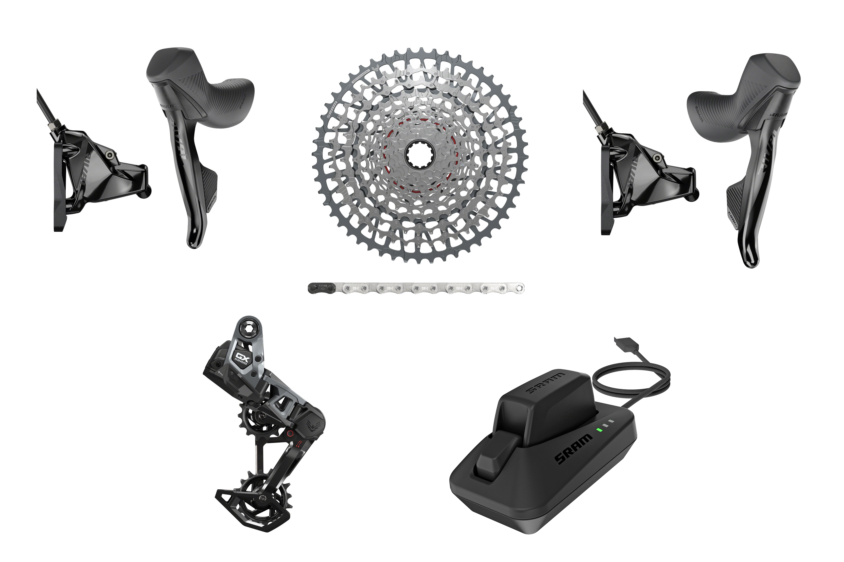

I was wrong in saying the cassette was Rival. It came with the mullet groupset. It is a SRAM GX Eagle cassette (10-52) with a GX derailleur and chain. The shifters and brakes are Rival but the drivetrain is all GX. Here's the group I bought from Pro Bike Supply:
I'll be moving my Shimano Ultegra DI2 group from my V20, where it works perfectly, to the Q45 next week. I ran the same group on my S40 with no issues. If it works on the Q45, I don't know what to say. If it doesn't, there's something wrong with the bike.
