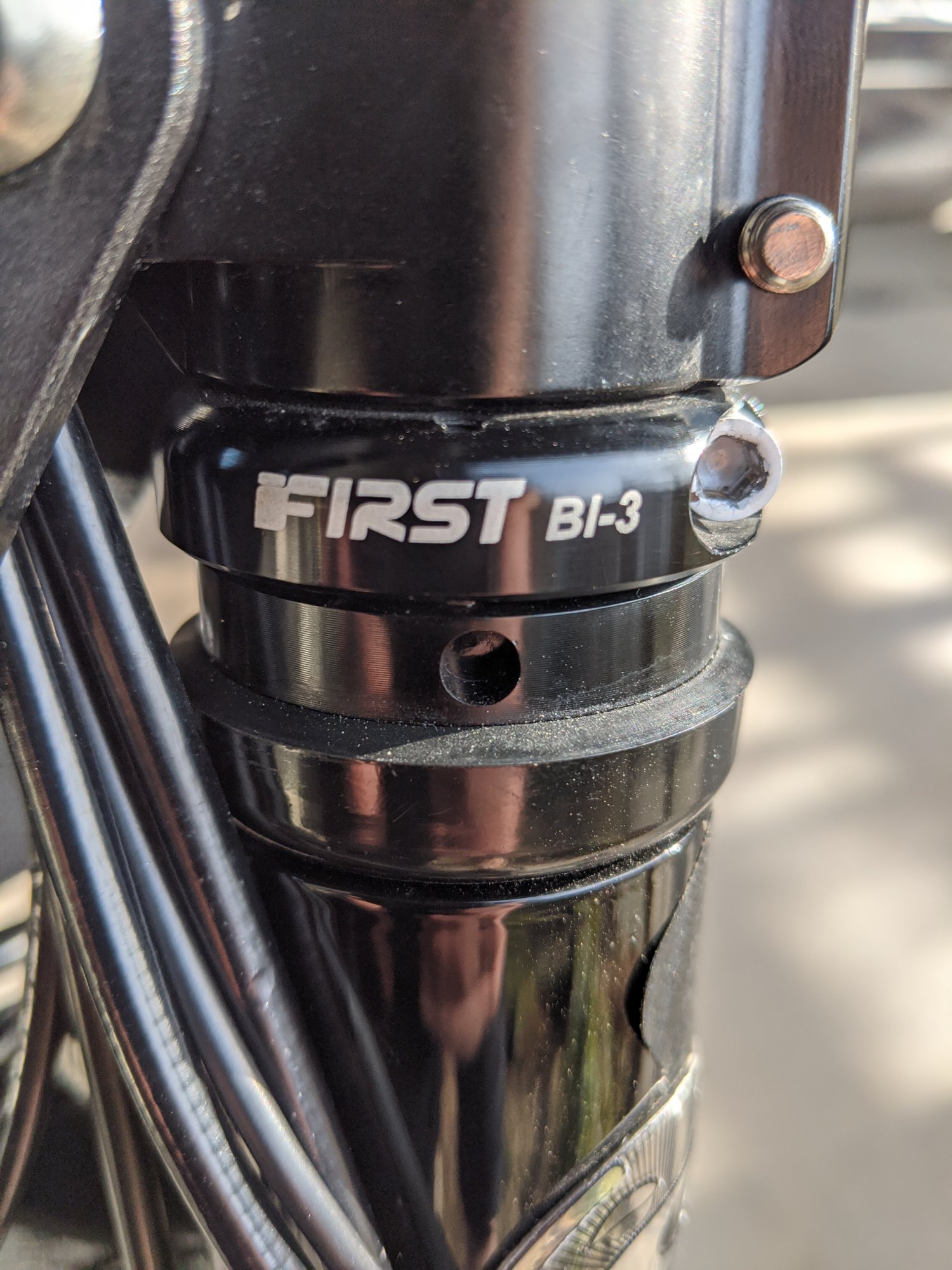

Did all QX100s come with Diatech Headset?
Emeljay
WiskersBlowinInTheWind
Headset itself I don't know, but to adjust the bearing compression mine says FIRST BI-3. This is different from my Q559 which says Diatech.
The serial number is on the bottom bracket.
@Scott No, that is not a Diatech.
