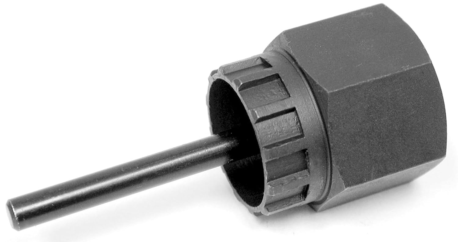

Nothing to it Abbott. You have a couple of options. Remove one of the smaller cassette cogs, 13-15-17, and place the new 42t first on the wheel spline/hub followed by the other cassette cogs. You also have the option to replace 15 and 17 cog with a 16t. I didn't like the the shifting ratio jumps from 13 15 19, I missed the 17, seems to be a gear I spend a lot of time in. I tried removing the 15, and did not like that either. I found the cog I used least was the 11, so I removed that and purchased 13t lockring from Absolute Black out of the UK.
Tools required are: Cassette/Rotor Lockring Removal Tool
...and Sprocket Remover/Chain
Thanks Rick. The 13t lock out ring was the piece of the puzzle I was missing. My friend is loaning me the necessary tools.
