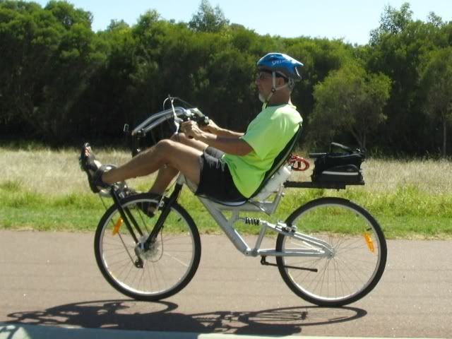

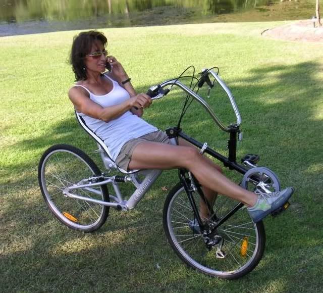

These photos are from the company website and show pretty much what we had in mind for ergonomics for the Freerider:
Note that the headtube falls right about mid-thigh; this generally will not interfere with your pedalling even during a turn. If you are doing a really tight low-speed turn, you may need to accomodate things a little, but this is probably a different riding situation from what you're asking about.
You'll find that the interaction between your legs pushing and your arms pulling will balance nicely if you have the seat somewhat forward and the headtube about mid-thigh. Having the seat rearward will amplify the effect pedalling has on steering, especially as you gain confidence. Once you are accustomed, you can ride a Cruzbike in about any configuration.
