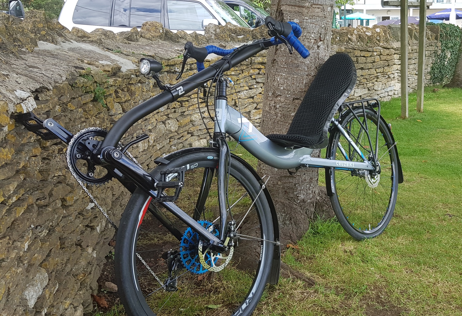

Ray (@rfneep ) of this parish fitted his S40 with a Granny gear on the casette rather than a smaller chainring. I bought it off him a year and a half ago and it's very good. Specifically it's a Wolf Tooth GCX 46t which has replaced the stock 42. And in all honesty if I get to the bottom of that one it's so steep that walking's just as quick.

I use 11-speed Sunrace 11-46 Cassette with the stock SRAM Apex that came with my S40 and it works.
Below I changed my chain ring to 48T and added a couple of links but the stock 42T SRAM chainring and the stock chain would have not required an increase in the chainlength.
In bottom gear the tensioner is pulled out straight. You could ride on bottom gear without one. In top gear it is folded in almost as far as it can go. They must be approaching the limit of possible range of ratios. If you want more cogs in the same frame you have to make them and the chain thinner. Or start selling frames with wider drop-outs. Aargh, a new standard! In that case, what is the limit of cross-chaining? Or could they make a thing where the chainring slides sideways?
