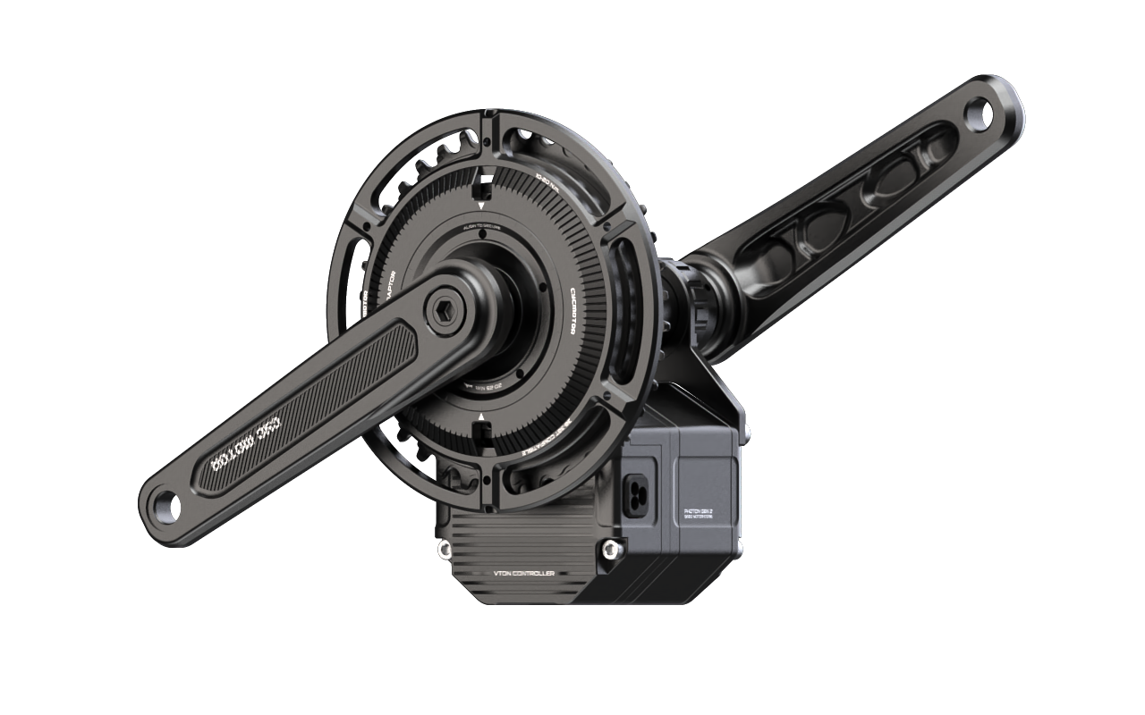

- Crank motor (not sure if there are compatible ones), lots of weight in a bad place.
