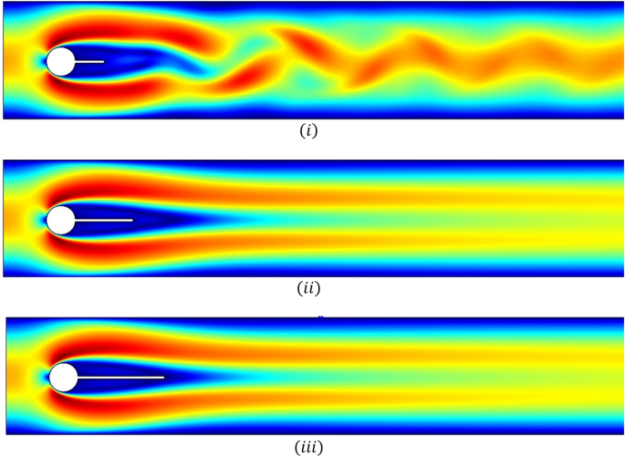

There are two schools of thought on the matter. First one is what you said and applies mostly to DFs. Second school of thought will apply to recumbents more is a rear disc wheel could behave as a narrow tail fairing by dividing the rider's wake into two smaller areas of turbulence, partially streamlining the bike+rider. Hard to describe. Check the following images.

I wish I could answer the triangle aspect of the equation but don't know because I don't have a Vendetta and never covered that area. Others would know better, especially Larry, who is the king of Vendetta applied aerodynamics theory. What I do know is the Vendetta would benefit most from a rear disc for two reasons. First one is obvious because of sheer speed. It's faster than any other Cruzbike. The faster you ride the more aerodynamics plays a role at mitigating speed potential. Secondly, the seat angle and height from the ground is lower. That means more of the rider's body is being 'faired' by the rear disc wheel on a Vendetta. It's more like a lowracer than any other Cruzbike. Of course, true lowracers see the most benefit because the rider's entire body is being faired by the disc wheel. Hope this helps.
Yes, the critical issue is the shedding of unsteady Von Karmen Vortices which produce high drag. Splitting the flow reduces this tendency.
