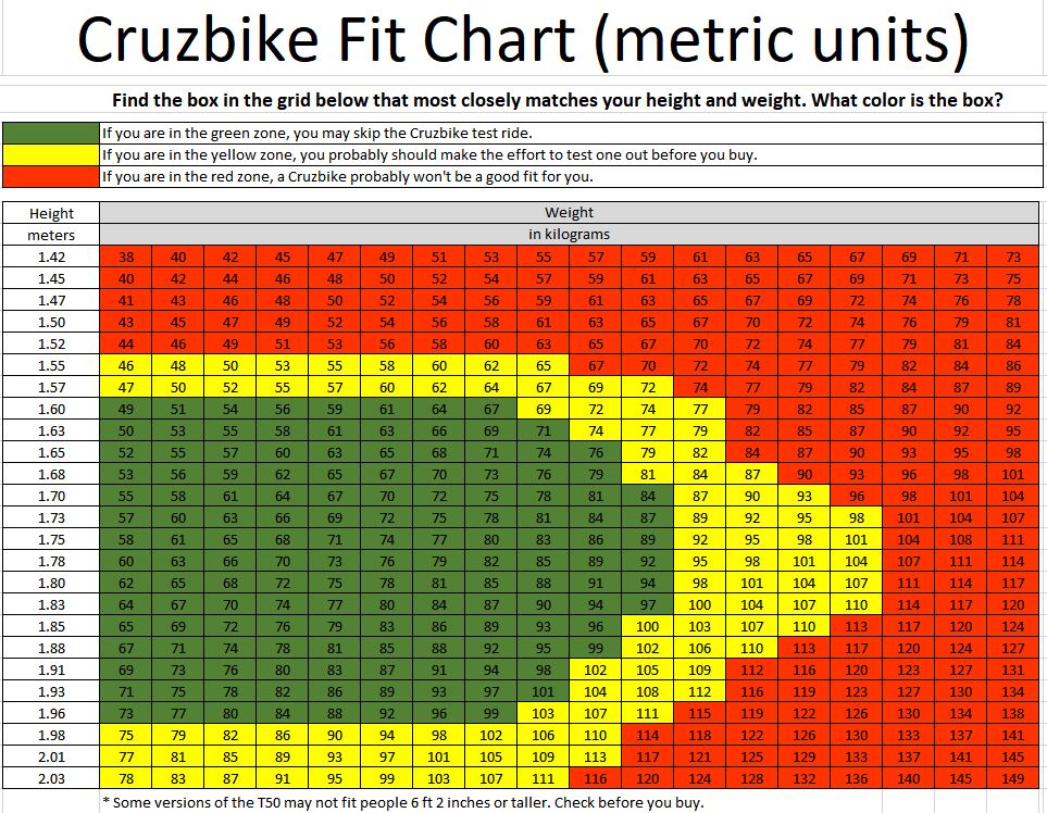

Too big or too small for Cruzbike? Check the Chart. Take the Poll.
What color zone does your height and weight most closely match? Do you ride a Cruzbike now?

I recently wrote a blog about which potential Cruzbike owners should definitely find a test ride, and who may go straight to owning a Cruzbike without much worry that the bike won't be a good fit.
I created these charts based on my experience with customers and the bikes. I'd like to know how folks on the forum fit on the chart. Are there many people in the yellow or red zone?
To complete the poll, indicate which color zone you fall into, and then whether or not you currently ride a Cruzbike. If you have thoughts about fitting on a Cruzbike, please share below in the this thread. Thanks for your feedback.

5'6.75", 168 lbs and in the green zone on Ken's chart. Is the green zone intended to imply that a buyer can expect the Cruzbike to fit "out of the box", without additional cost mods? Or does the green zone indicate that with sufficient effort and, perhaps, additional expense one can expect to get a workable fit?
I could ride my S40 with the stock setup, but I certainly wouldn't consider it optimal -- or even reasonable. Swapping in a short chainstay, and to a lesser extent changing the 700C wheels for 650B, improved the fit enormously. I find it very odd that the existence of different length chainstays is not mentioned anywhere on the Cruzbike retail website (that I could find) and I'm enormously grateful to have seen them mentioned here on the forum. I do wish the seat had some adjustment, since us untall folks have considerably less weight on the front/driven wheel and end up with a higher BB height, despite our shorter legs. I'm considering getting the extra, super, mondo thick Ventisit seat pad to move myself further forward in the seat, giving weight on the front wheel more like what I suspect the design intended and allowing the BB to be rotated downward a bit.
