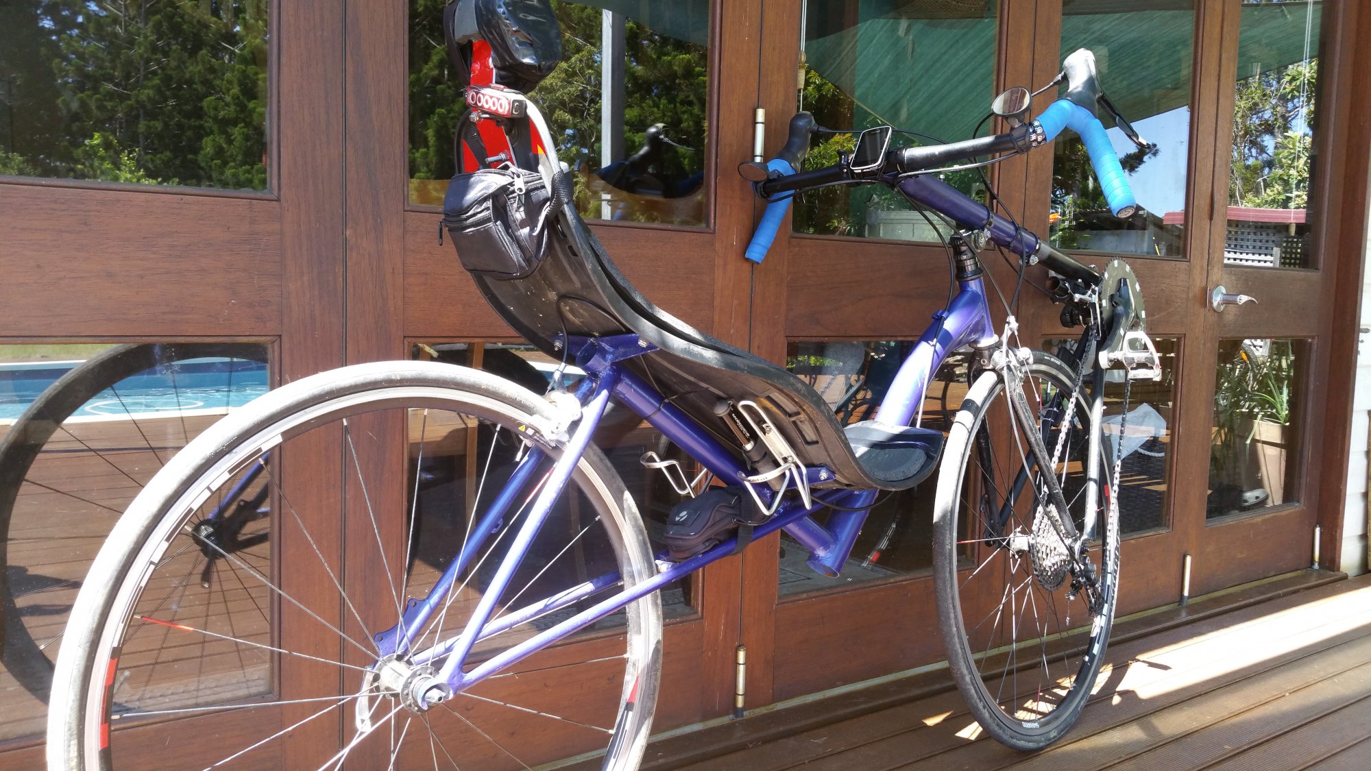

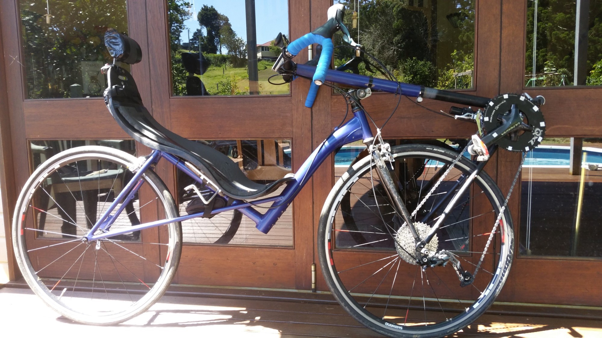

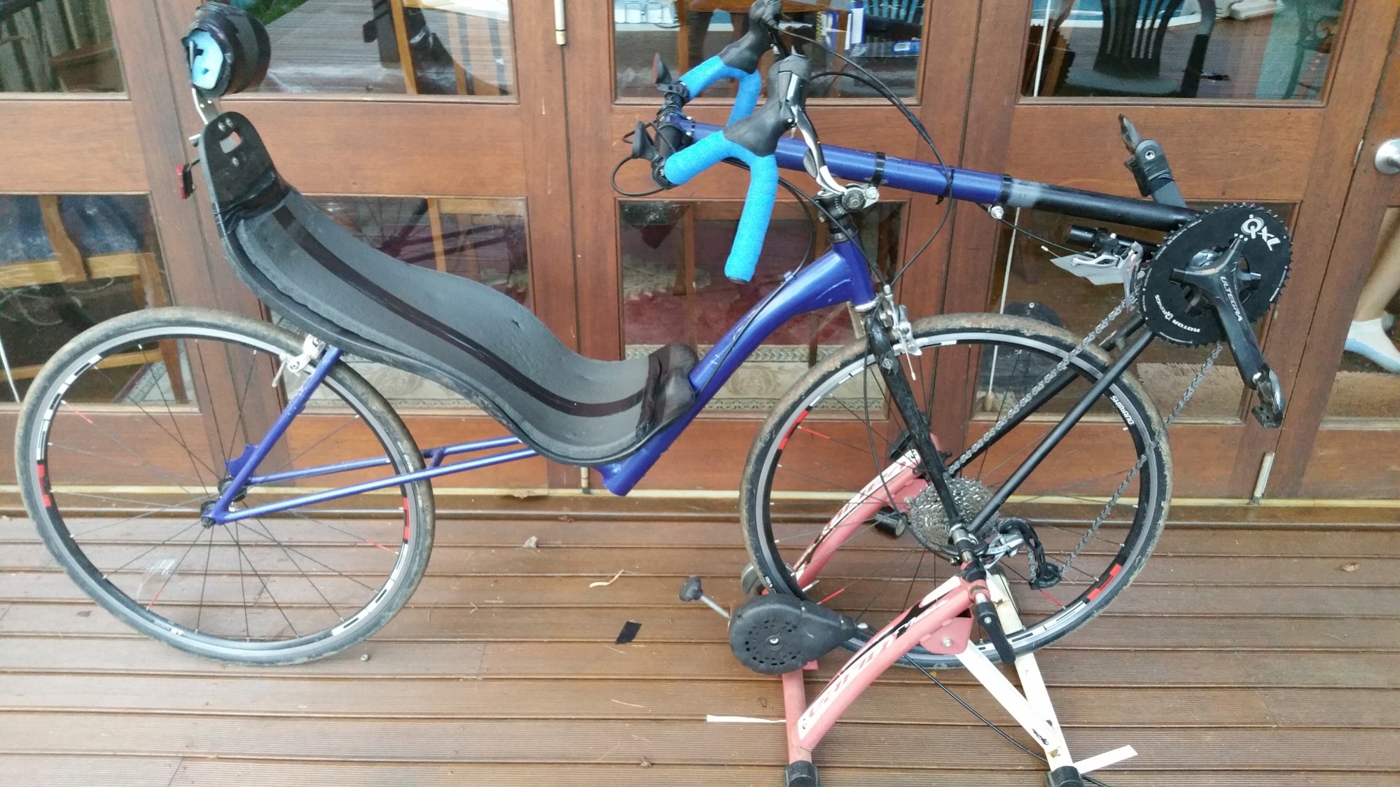

still saving but anyway.... No2 has had its shakedown rides and now ready to be stripped down and resprayed (I like the bar tape that much)..... stats are ..... 1200mm wheel base, 70' headtube angle, 520mm seat height, sora derailers and brifters, 9speed 11-36 cassette, ultegra 6800 165 cranks with qxl rotor 53-36 crankset, 9speed shimano r500 wheels, s40 bars (thanks Joy), 19.5 chain stays, mostly 4130 some but donor tubes are Hi-tensile making it 14kg (will replace those tubes with 4130 or Ti. later), I do have a 11speed hydro grouppo and wheels but they're for the V20 when it comes...... hopefully everyone is happy with the rear triangulation of No2!!! I feel safe on this one and power delivery seems pretty good but having two months off a bike(whilst building) has given be chicken legs Jond would be proud of....
