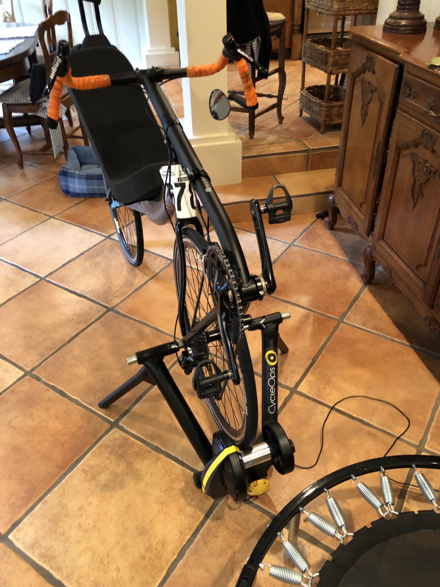

Thank you @ratz for putting the info together in this thread. I had my S40 shipped to where we were vacationing so I could learn how to ride it. I got to ride it for the first time again back home this morning. A big rain event is happening all day so I brought it in and put it on the Cyclops trainer. However, the front skewer is not long enough to reach the nut on the other side of the fork. So, I just put the skewer in and got everything lined up and dropped the nut in and clamped it in. It seems to work. Has anyone had to do this? Will this cause any problems to the bike or the biker?

Go to the nearest bike coop, store, outdoor store (Mountain Equipment Coop, REI, etc.) and ask for a training skewer. They usually have extra threads to make the skewer longer and usually have a bit of a different shape to fit in the trainer nicely. Typically they cost very little all things considered. I think mine was $14CAD. Alternatively, you could get one from Cycle-Ops which might cost you a couple donuts more.
And with a Cruzbike you will want something to keep your trainer anchored, especially on that tile floor! Mine slides across hardwood if I don't have something bracing - normally I just turn around the boot mat so it has the short edge against the wall and the other edge against the rear tire, and the trainer is on one of those 2' square foam rubber garage / children's area mats. Works pretty well that way with only occasionally I pull too hard on the handlebar and get things a little skewed and have to reef the other way to straighten out.
And, if your trainer is directional, then you would need to put the Cruzbike in the other way.. That is, pretend the drive wheel is going in the trainer for a Diamond Frame bike, the flywheel should be towards the rear of the bike. Is that a magnetic trainer? It might not make any difference then, with fluid ones it sometimes makes a difference and of course with the wheel-less ones you can only put it on one way.

Many thanks @benphyr. I have the Cyclops Magnus. There are references on the forum stating this particular trainer will not work with the S40 due to the width of the forks. I was able to ride 5 miles without any perceived problems, just trying it out. That was without the ends of the Skewer being physically connected. Not sure if this would cause a compression on the bearings or not. I googled to see if I could find a long skewer without luck. I’ll check with the bike shop Monday.

Oh yes, the rear tire kept sliding sideways. I put it in my bike stand and that seemed to help. I’ll try your recommendation
