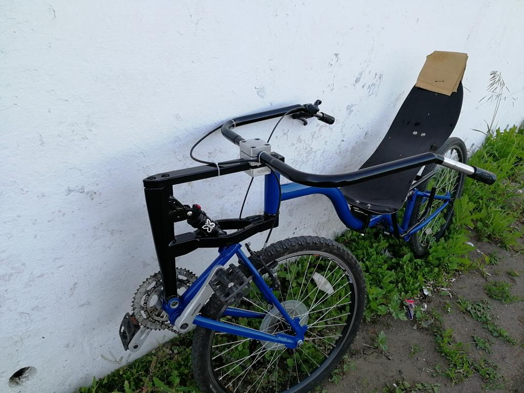

Fully suspended MBB with 90 deg steering angle.
The project is nearly complete, I think I can showcase it now :).
With bars (not entirely happy about them, but I need wide bars to clear my monumental thighs - this one has 680 wide bars, at least in line with a 'conventional' MTB and must fit ALL the doors :).)
This is a very budget build, using 'wallmart' FS bike components. My goal was eliminate wheel flop and keep steering inertia to a minimum and BB and seat as low as possible, yet keep 'tiller length' in check because my last project, while perfectly rideable and even decently fast, is not very comfortable in that respect.
Should be perfect for bad roads and mild offroad, where MBB is great due to no foot-wheel conflict in turns and ability to install dual large wheels with wide tires.

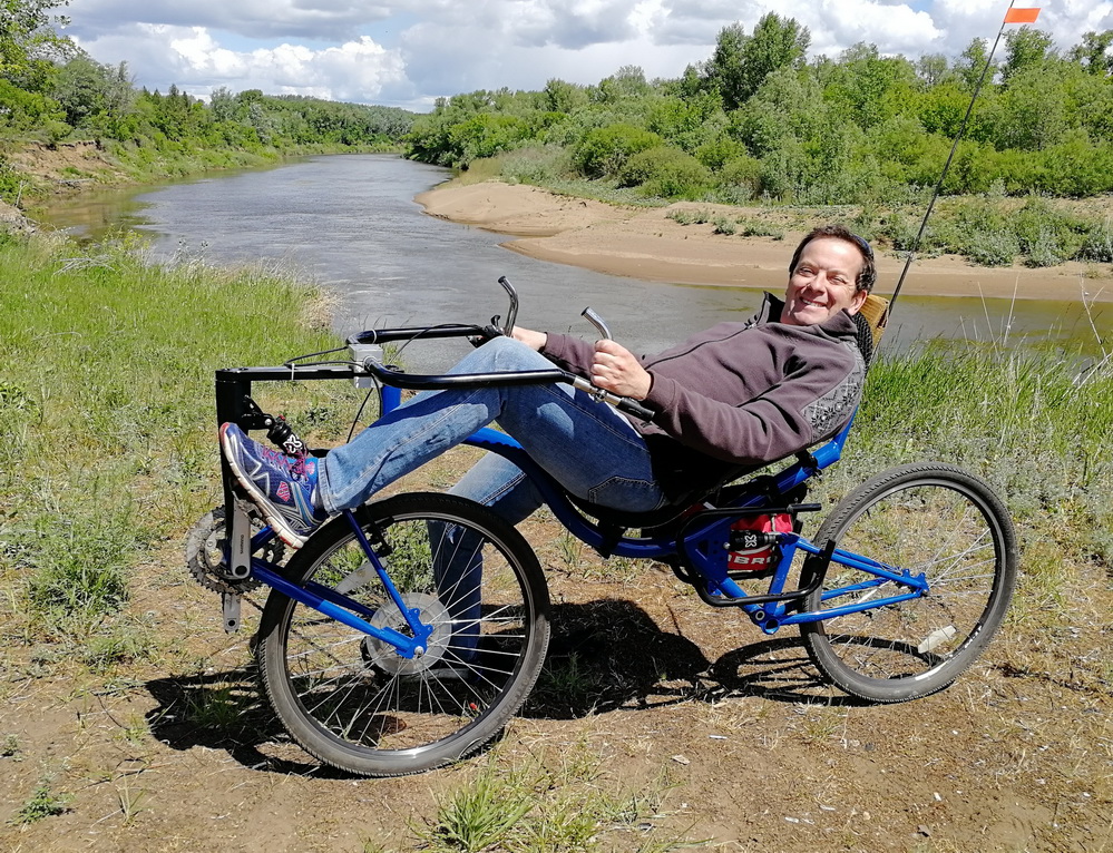

It would be a while before I, myself, will be able to ride it, but the builder reports that suspension works great and does not bob much, and he was able to hop on and ride off right away, almost no 'MBB learning' required.
It is made of steel and, obviously, weight about as much as two Vendettas :)
By the way, there is a funny thing about FWD 'reverse bob' (it extends instead of compressing, due to reversed weight transfer and tire forces) and climbing steep inclines.
As you climb steep stuff, you front end is unweighted, hence, if you run little sag - you get zero sag and, therefore, zero bob exactly when you need it most! Kind of 'intelligent lockout', only 100% passive.
Cannot have that on RWD, ehehe. Talking about 'turning a liability into an advantage'.
Actual springs at both ends. Underseat rack. Lots of space for another rack above the back wheel. The bars make it easy to prop it against a wall. All of which is cool.

Not exactly a ton, and radius makes much more (squared) difference than sheer weight. Plus, most of the weight comes from the legs (certainly in MY case).
What I'm not happy about is bars. I'm currently in brainstorming phase with the builder - how to improve them, possibly.

It's a very nice looking recumbent/liegerad! I would suggest using Cruzbike's "dynamic boom" and drop handlebar.
That's a possibility, yea. "'Superman" bars are good offroad however, because they allow fully unimpeded entry/exit and ability to manuever sitting up, which is much easier... and this bike is not intended for speed records anyway.
I think I'll order a "cruzbike type" boom in addition for test, if it will not turn out took expencive :).
The builder embarked on a 50 km ride, found it easier than on MTB - he swapped bikes with his buddy, who also hopped on and rode off right away, and also was faster than on MTB.
Neither of them are strong cyclists though.

That's quite the thing, and I definitely appreciate the courage of your convictions to see it through to a working prototype. We now stare starkly at the difference between Can We (yes) and Will We (?). I certainly think there's quite a lot of scope to simplify the design around the key concept of the steering column being slightly ahead of the front axle, although in fairness you did add the suspension in there too, and with non-bespoke parts.

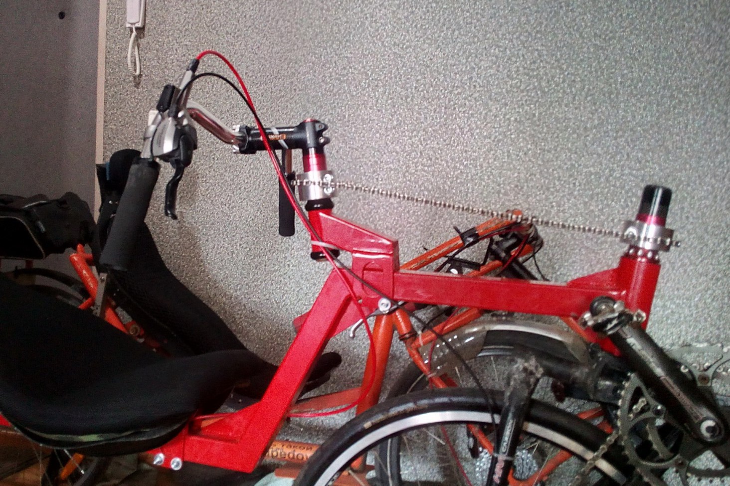

How about this? You can move your knees sideways and the bar is out of the way. You can hold on the drop handlebar at three locations plus one on the brifter hood.
Well, there is nothing "magical" about negative offset, in fact zero offset with about 80 deg steering angle also have its merits (search velodreamer on facebook, he made MBB with cruzbike-like boom using this geometry).
It allows to have much less flop (above zero tho) and steering inertia as well, but with more conventional-looking geometry and less "tiller".
But if you want to have a suspencion, a combination of 90-ish steering angle and negative offset seems like a good design choice.
Besides weight, only disadvantage is "people below 170 cm need not apply" - due to space needed for suspencion travel, unless designed around 24" wheels.
