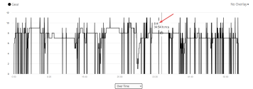

How the Gear indicator shows up in Garmin Connect after a ride :
