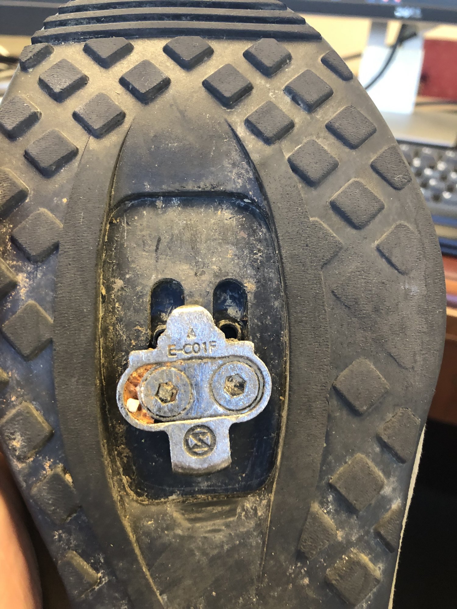

Try putting your cleats mide sole - that have helps many people. I just made a small adapter out of 1/8" thick aluminum for my look cleats. Works great - have never had hot foot since switching and I would get it regularly. If you are a "point your toe" pedaling you will have to move your boom in or shorten your cranks because mid sole cleat will shorten that distance. If you already pedals with you toe pointing straight up then you will not need to do anything
They are currently at the farthest back "standard" position possible. Moving them back further would require significant re-engineering. Note that I wear MTB shoes and SPD cleats ( because 85% of my mileage is commuting, and it's much better for actual walking to/from the office/locker room). I will re-engineer if needed, or buy what I need, but looking for easiest solution first. I may start a new thread on this if it get interesting.
Second vote for the cleat position. Mine are not true mid foot but rather the back most position on Shimano mtb shoes which I think is about as far back as one can go w stock materials. Has made a huge difference.

Another midsole cleat convert, used a grinder to make room further back for cleats , drilled a couple of new holes in carbon soles and repositioned plates for screws.
No more hotfoot , and I feel like I can spin faster.
This may be doable. I have and older pair of traditional Road shoes that I can test on. Will report back when I get time.
