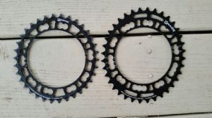

As you can see the Q34 is not much off of rounde.edit to add pix of the old Q34 (left) and the new QXL36 (right)
Yes - I would agree - the Q is almost round and I personally never noticed any difference. - Go with the QXL 36.Is is good idea to test QXL 36 as my first oval chainring?
Agreed the QXL 36 and 38 are much better for you cycling fitness level and the events you ride.As you can see the Q34 is not much off of rounde.
