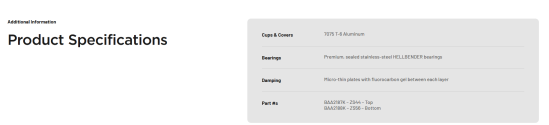

Confirmed, the viscoset ZS56/40/H8 works on the V20C, and since it's under the headset, you get a straight 1/4" lift on your seat and handlebars. I can confirm you can roll it around just by hanging onto the headrest without the front wheel flopping around. I have mine tuned to maximum friction, and it's stiff but smooth. Sadly, it may be another month before I get to properly test it on the road at high speed because it seems like FedEx has lost my Thor seat but won't own up to it. Once I do get my Thor seat, I'll be sure to take it down Mt. Baldy road where I'm typically between 50-60 mph and the road has those damn horizontal cracks that bounce you up into the air mid corner. If I gain any stability or confidence on that DH, I'll consider it a huge win.
