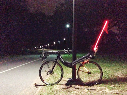

That lighted flag poll on
That lighted flag poll on your Silvio is just wicked cool . Nicely done!

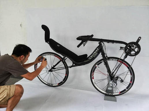

Silvio had a photo shoot
Silvio had a photo shoot yesterday, followed by her third road ride tonight. 50+km along the coast and to the airport made for a nice late evening ride. I am getting faster, but more importantly getting more comfortable and enjoying the ride. So I shan't worry too much about speed but focus on technique and keeping a straight line. I am fine in light traffic but would not yet venture out for my commute. Now I am stopping in the middle of lanes at the lights, and finding out that starting at a traffic intersection with vehicles all around is more difficult that on a bike path -- the pressure is on!

I finally figured out a way to attach my son's led flag to Silvio. A mini-pump holder mounted to my bottle cage bracket behind the headrest served perfectly. The pump holder grasped the flag base. Now I have a flapping, blinking light saber to keep me safe. The under seat bottle cage holders worked well.

+1 for wicked cool and
+1 for wicked cool and concentrating on technique now and speed later. As Yoda and Obi Wan would say, "Use the Force Ivan, use the Force"
