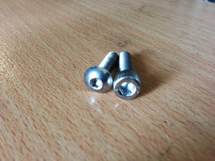

Bottom Bracket Clamp Bolts
When I first assembled my Silvio, I think I used the wrong bolts in the C-clamps that hold the bottom bracket. I probably mixed them up when taking out all the bolts and parts. If you are assembling, please use the correct bolt on the RIGHT in the following picture.
IMG_2145.JPG height:527px; width:703px
Because I used the wrong bolt (above LEFT), and the head on this bolt was small, it stripped easily. Today, I finally managed to remove it by cutting a slot with a dremel tool and getting it out with a large flat-head screwdriver. Thankfully, no damage was done to the frame. In the picture below the bolt on the left is the correct bolt, and the bolt on the right is the one I cut the slot in to remove it.
