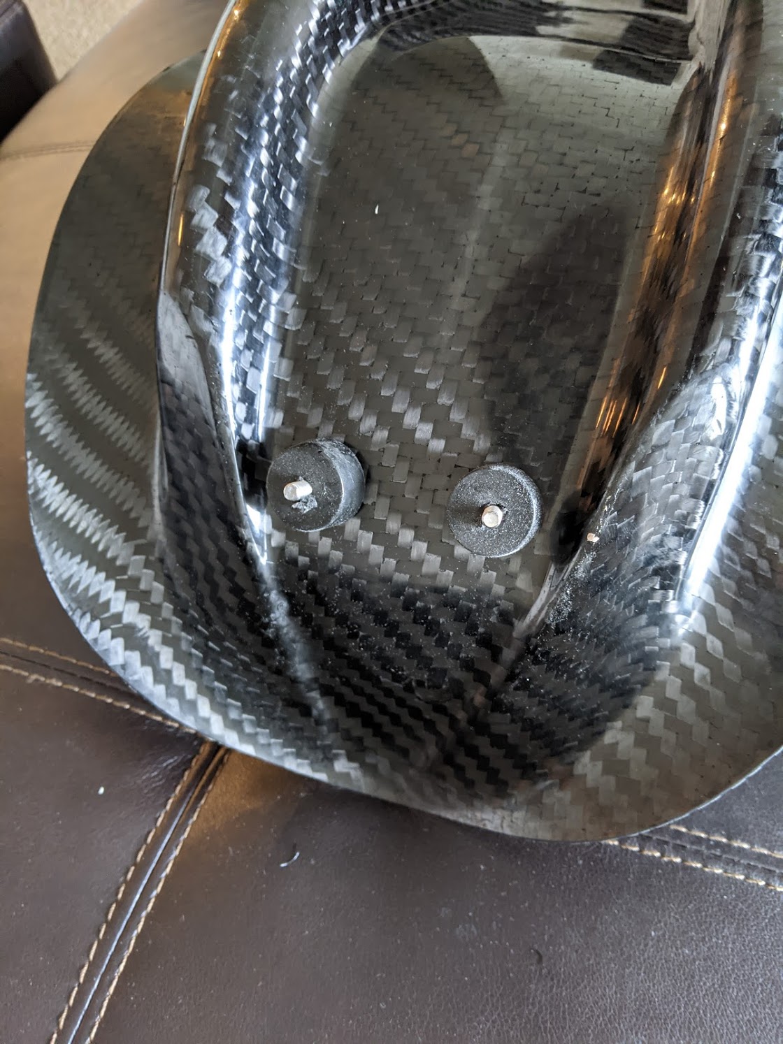

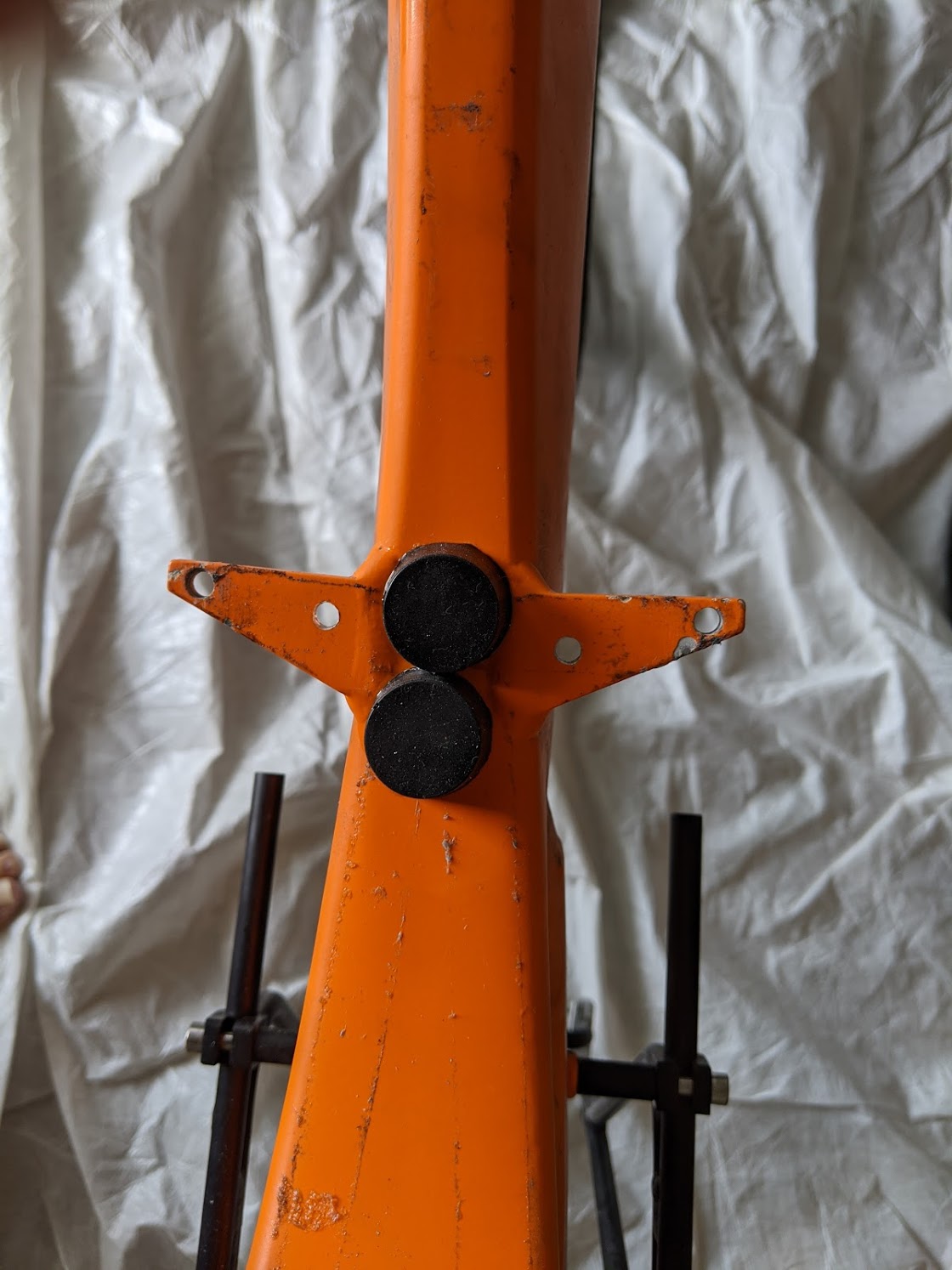

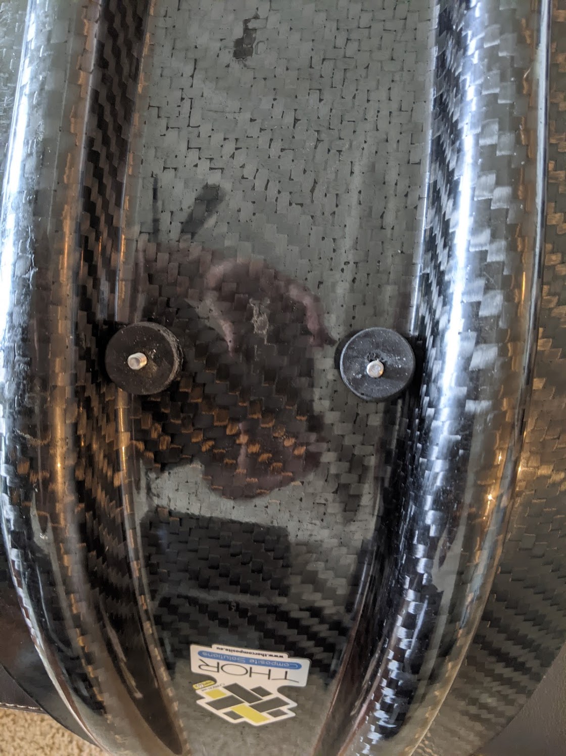

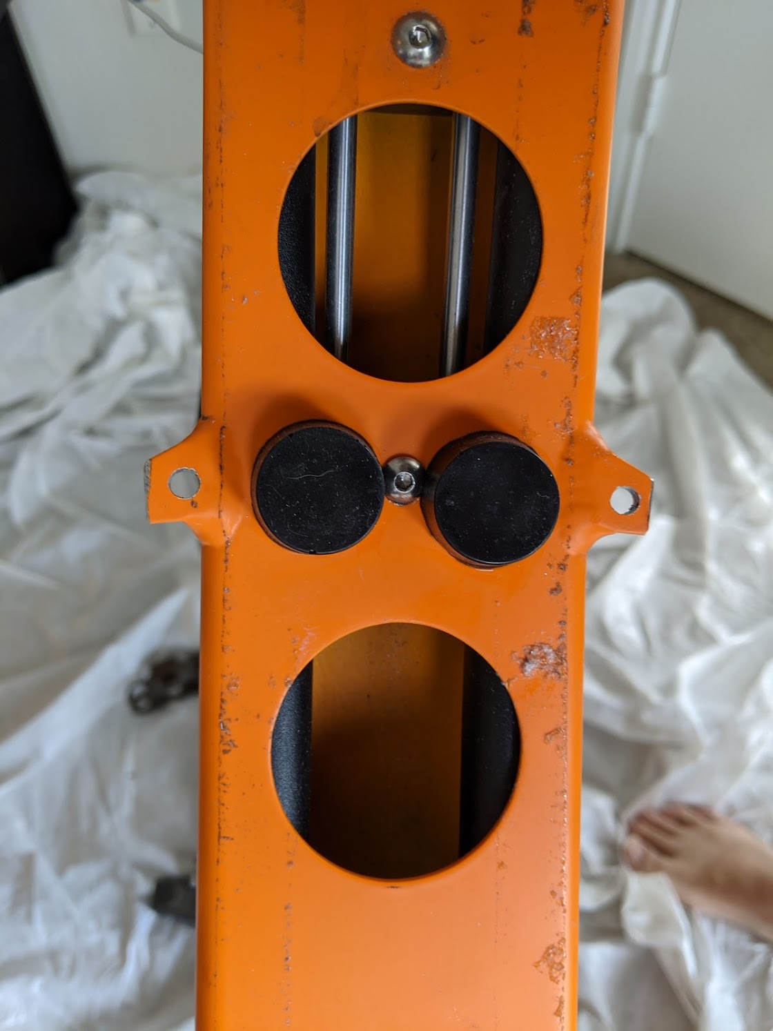

Thanks Rudy. I bought some moldable plastic but I'm going to give sorbothane spacers a try first. If that's too squishy/wobbly, I'll replace them with the plastic blobs.
Update: I mounted the seat with the sorbothane spacers. Seems solid.
Black Hawk Down
Senior Rookie
Awesome. Did you get any pictures of the process?
Not too many shots. Just the placement of the sorbothane pads on the frame and seat. I cut off the back tabs and drilled new holes on all the tabs closer to the frame. Bit of a pain due to the welds. Had to open up the holes so the screws could move away from the frame enough for the lock washers and lock nuts. I tightened down the screws until the sorbothane started to bulge. The seat seems quite secure. Solid.

On the back of the seat, you would have to file into the tab hole. I decided to cut the tabs to eliminate the entire hole as I would need to drill new holes anyway. Didn't cut the front tabs as the spacers are tall enough so the tabs don't interfere with the seat ribs. I did need to drill new holes in the front tabs so that the spacers don't interfere with the ribs. I haven't taken it for a test drive yet as it's in the bike shop with front derailleur and disk brake problems.
