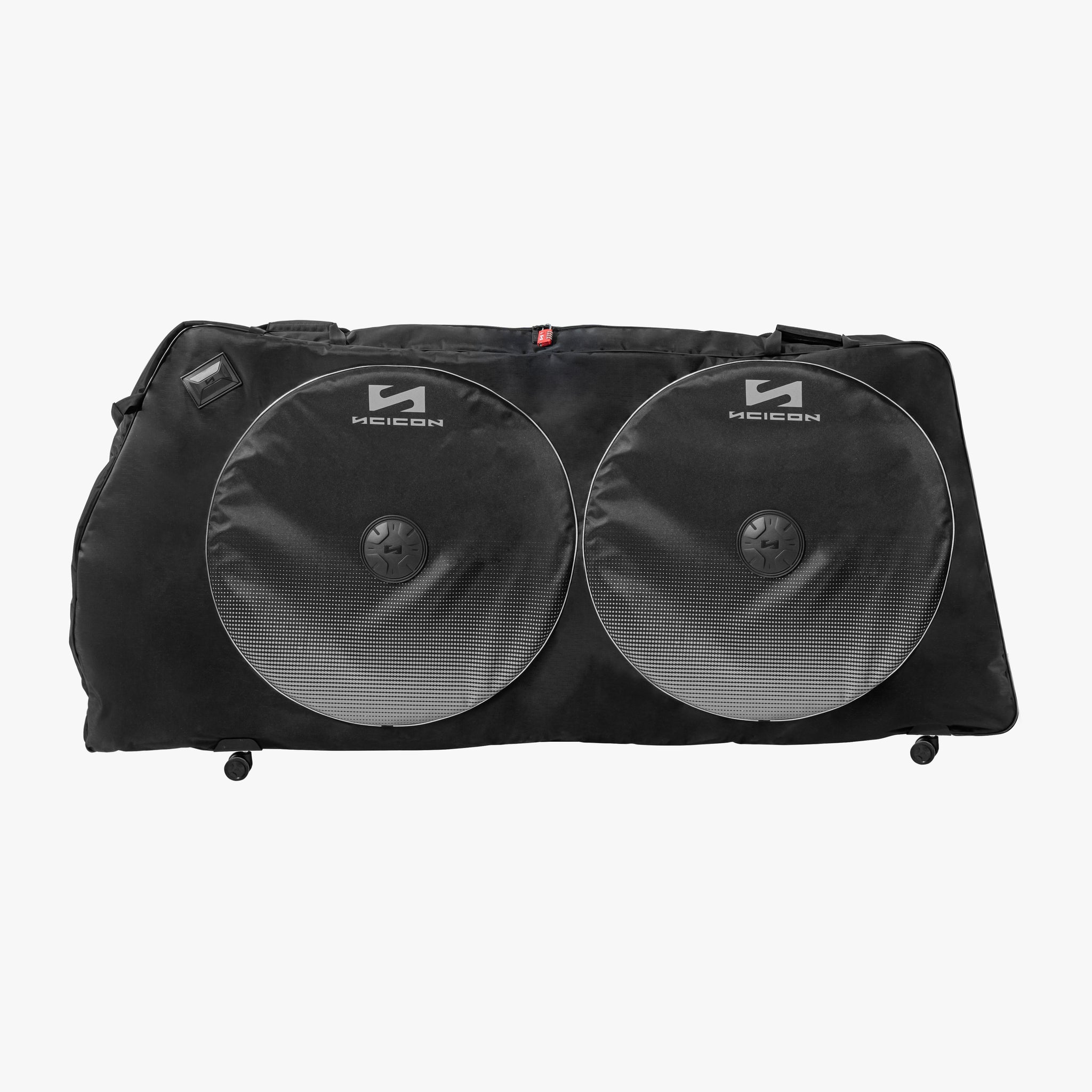

OK. I'm fairly convinced if I can pack my S30 in a box and successfully get it to Paris, unpack it and re-assemble it, the ride will be relatively easy and stress free from there on. Back in March (it was snowing) someone posted to the New England Randonneur group that they were downsizing and had a bike box they couldn't use anymore. Great, I thought, this will save me the effort of choosing a bike box. And with the price - "free" - I could swallow any baggage fees and not beat myself up for not getting my S30 into the mythical non-oversized 24"x24" bike case. (The prior owner of the box, by the way, had upgraded to a bike with S&S couplings so he could get his bike into a 24"x24" case... but what does he know).
Tuesday night I disassembled the bike... but couldn't get it to fit in the case. I went to bed. Wednesday night I re-assembled the bike. It was good to prove to myself that I could and that I didn't do any irreparable damage to the drivetrain or the hydraulic brakes. Tonight (Thursday) I made some adjustments - removed the fender, the cranks - and tried again... et voila!
